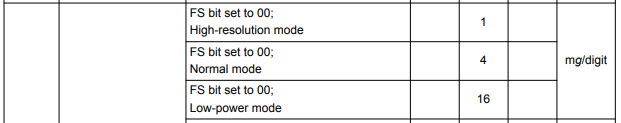

2018-05-22 12:00 PM
Your measurement is correct.
To get the acceleration value in g unit, you have to firts convert the raw data into signed value and then multiply it by sensitivity defined in datasheet.
So in your case for X, Y axis: 0 ... 0g, 255 ... -16mg, 254 ... -32 mg (basicaly noise). for Z axis 64 ... 1024 mg (gravity).
