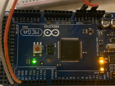

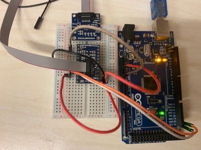

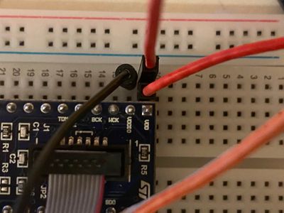

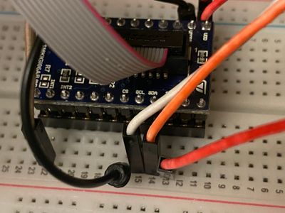

The Arduino can detect other I2C devices, just not this one. I've added pictures of my set-up below, the code i used was just the Arduino Playground code for an I2C scanner (https://playground.arduino.cc/Main/I2cScanner/)
