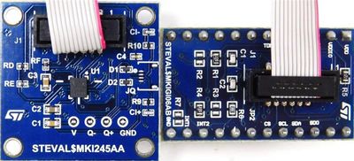

inside the evaluation kit STEVAL-MKI245KA there is one ISM330BX sensor mounted on the square board, while the other adapter (the rectangular one, called STEVAL-MKIGI06A, which is a DIL24 adapter) can be plugged into a standard DIL 24 socket and it is connected to the square board through the flat grey cable as shown in the picture below.
