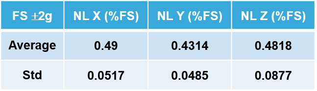

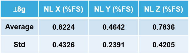

2021-03-23 9:39 AM
Hi @NPoth.1 ,
you are welcome.
For the bias stability, the observation period is 72h.
For the accuracy/precision parameter, I can share you the sensitivity error in non linearity:
-Eleon

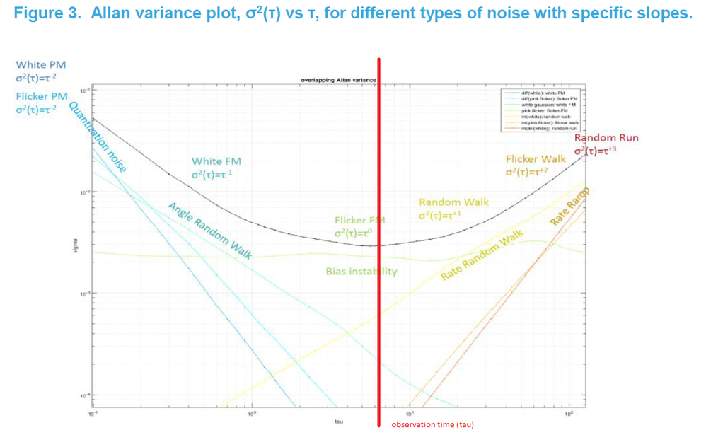

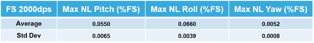

2021-03-24 5:08 AM
For the bias stability, I expected an "observation time" in second. For me, the "observation time", is the value on the x-axis (tau) where the Allan variance is smaller.

What about the accuracy/precision parameter of gyroscope ?
2021-03-24 7:24 AM
Hi @NPoth.1 ,
ok, I was thinking to the whole acquisition time. Yes, the tau unit measure (average time) is seconds.
>> What about the accuracy/precision parameter of gyroscope?
For the gyroscope I can share you the NL in the +-2000 dps case:
Other questions? :grinning_face_with_sweat: ;)

2021-03-24 7:34 AM
:grinning_face_with_sweat: :smiling_face_with_smiling_eyes:
So can you tell me the tau value for bias stability of accelerometer and gyroscope ?
Thanks for all !
2021-03-25 4:11 AM
Hi @NPoth.1 ,
the cluster time for both accelerometer and gyroscope in the bias stability region of the AVAR plot is about 20s.
