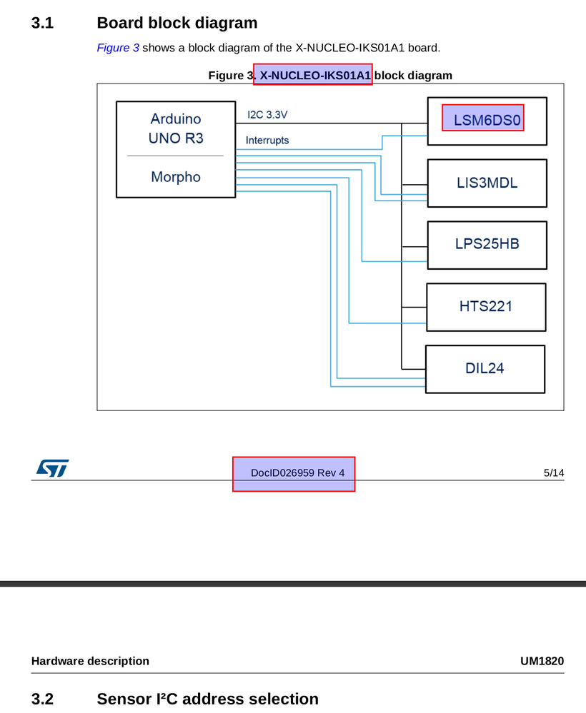

Currently I'm working with an "old" IKS01A1 expansion board which should be populated with a LSM6DSO 3D acceleration and gyroscope sensor:
But running the X-CUBE-MEMS1 software fails due to a wrong chip ID.
The software expects 0x6C but the chip has 0x68.

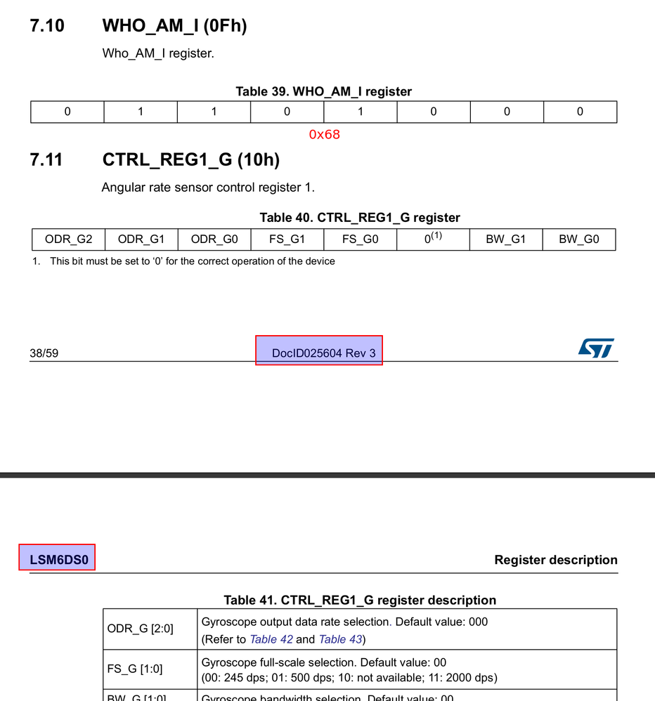

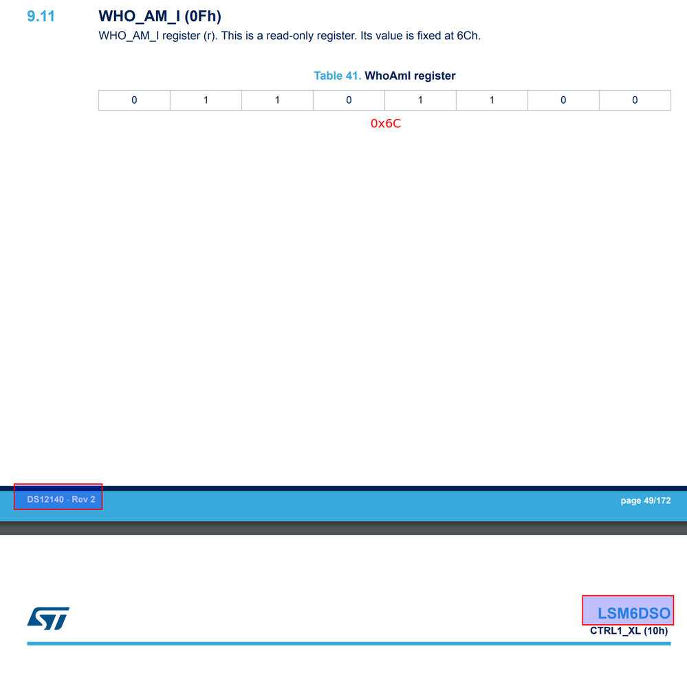

After downloading the newest LSM6DSO datasheet I can see the difference (and not only the chip ID ;-))
old version 2014:
lastest version:

​HI @Katzenberger.Michael​ , please consider that the X-NUCLEO-IKS01A1 mounts the LSM6DS0 (ending with number 0, zero), responding to WHO_AM_I = 68h. This is a different module (with different packages, pinout and performances) from LSM6DSO (ending with letter O), whose WHO_AM_I is 6Ch. Please note also that the IKS01A1 expansion board is in NRND state. Regards
