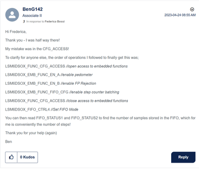

Screenshot from the closed thread mentioned by @Andrew Neil (Credit to @Federica Bossi) :
