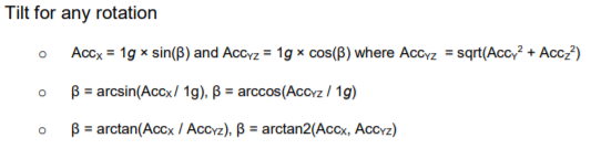

For example, at pag. 16 the trigonometric details are reported:
0693W00000JPTNKQA5.pngAs general suggestion, make sure that the device is well calibrated (i.e. the residual acceleration along the axis in a steady condition is close to the ideal value (0g or 1g). You can write the "calibration" value peculiar for each device in the OFS_USR registers.
