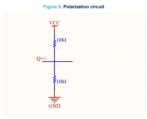

Btw, QVAR works well on my ILPS22QS breakout, but I see a persistent 1.5 mV offset even though I have an offset cancelling circuit (I am using 1% 9.1 MOhm resistors). Any idea what I could be doing wrong?

Yes, I am using such a polarization circuit with 1% 9.1 MOhm resistors. Yesterday I thought I measured ~1 MOhm resistance across my flex electrode, which would explain the extra offset; today I don't. But I take your point, in the circuit i could adjust the resistance to zero out any offset. In any case, the offset is < 10% of the full scale QVAR reading so doesn't affect detection of touches etc.

For point 4: the offset could be caused by a series of internal misalignments. It is not so high in our experience, but it might be minimized by fine-tuning the external resistors. Are you using the suggested polarization circuit? If so, you can fine-change the resistors to get a 0V output.
