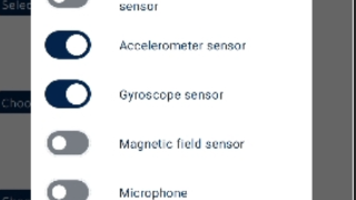

For your application to have 60Hz both for ODR gyro and XL you can follow these steps:
After connecting to the board, click on FLOW -> Expert view -> New app
Then click on Select Input and follow these screenshoots:

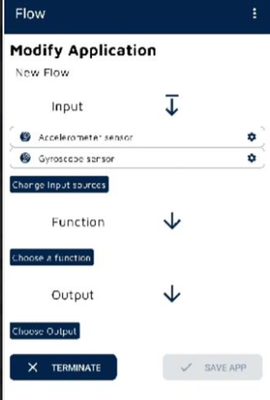

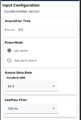

Finally, click on the gear (near the label Accelerometer and Gyroscope) for each sensor to change the ODR:
Select output as STREAM TO BLUETHOOT
At the end save this flow and click the arrow near the flow name to load the flow on the board:
