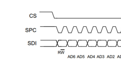

AScha.3
Super User
1. how you set cpha+cpol ? i think, your IR chip wants: cpol hi + cpha 2 edge
2. basically you can read 4 values in about 0,5ms at 250k speed;
IR update rate is 1...10Hz typ. , so 100...1000ms between accesses.
so need 0,5% cpu time at 250k rate -- what you want to gain here ?

Hi!
Thank you for your reply.
It doesn't work with cpol hi + cpha 2 edge @8 Mbit/s?!
