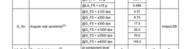

You can refer to the Datasheet.
You need to multiply the raw data by the sensitivity depending on your FS:
