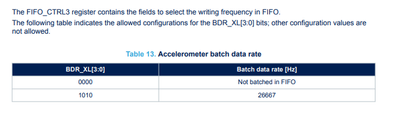

It is the batching data rate and the unit is Hz.
if BDR_XL is 0b1010, Batching Data Rate is 26667Hz.
Then, if BDR_XL is 0b0110, what is the Batching Data Rate?
Federica Bossi
Hi @HKim.23 ,
As written in the application note, the only two possible configurations are 0000 (default) or 1010 (26667Hz):
