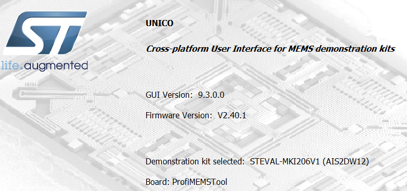

Hi @CBalt.1​ , AIS2DW12 is currently supported by the last Unico version, as shown in the picture below:
I would suggest you to check if you plugged the audio adapter in the right orientation, to be sure the USB cable is not power-only and if the device you have in hand is effectively an AIS2DW12. Do you maybe have other samples / eval board to do the connection check?
