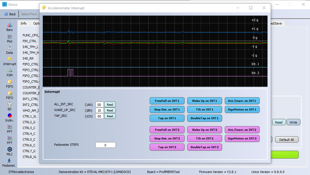

About the overflow event, you can detect it by reading (in polling mode) the FIFO_ OVR_IA bit FIFO_STATUS2 (3Bh), Otherwise, It is possible to route for example the FIFO_WTM_IA flag of FIFO_CTRL2 (08h) to the INT1 pin by writing in register INT1_CTRL (0Dh)(INT1_FIFO_TH) = '1' or to the INT2 pin by writing in register INT2_CTRL (0Eh)(INT2_FIFO_TH) = '1'. Then you can plot it on the Unico-GUI interrupt panel.
