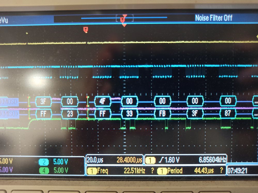

I try to use MLX90393 with my STM32-F4 DISC board on SPI2.
I can communicate with it, read and write non volatile memory, he responds to me.
The steps that I'm doing are:
  1. Go to Single Measurment mode ( 0x3F )
  2. Send Read Measurment command ( 0x4F)
  3. Read measurments and go back to step 1.
After SM command I get 0x23 status, which means that:
  • I got into SM mode
  • I have all bytes of data to receive
After RM command I get 0x33 status:
  • I am in SM mode
  • I GOT AN ERROR
Then I tried exiting and reseting, which helps with an error bit, but then after writing RM command i again get an error.
Basically, I always get an error after RM command.
Here is what i have in registers of non volatile memory:
  • REGISTER, 15-8 bit, 7-0 bit
  • 0x00, 0x72, 0x7C
  • 0x01, 0xC0, 0x00
  • 0x02, 0x00, 0x05
  • registers from 0x03 to 0x09 have 0x0000.
What am I doing wrong? What is causing this error?
My baud rate od SP2 is 562.5 KBits/s so I assume that it's not the high speed.
Here is a picture of what I get.
Maybe it looks normal, but the error bit worries me and data doesn't change when I manipulate with magnet.
Thanks for your help :).
