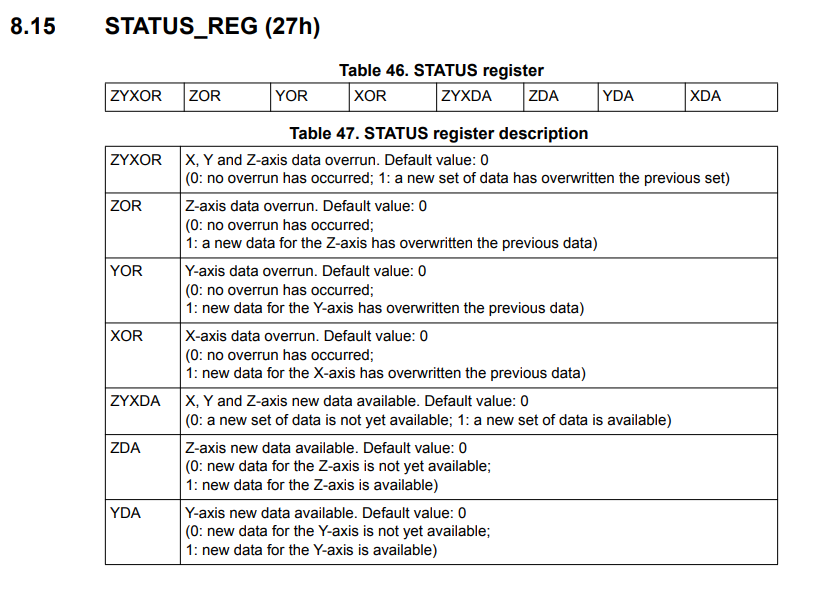

Now I am reading the measurements while waiting for the ZYXDA register ready bit STATUS_REG(27h) set. FIFO always enabled in Stream mode.
But this metod may not work when reading the FIFO part of the measurements. Should I change the read algorithm when reading data from FIFO?
I think this is the algorithm:
1. Read FIFO 32 measurements on wakeup by observing the EMPTY bit of the FIFO_SRC_REG(2Fh) register
2. Disable FIFO by resetting FIFO_EN register CTRL_REG5(24h)
3. Read 600 - 32 measurements waiting for ZYXDA bit STATUS_REG(27h)
Or is it possible somehow easier?
In the DocID17530 Rev 2 and AN3308 documentation, I did not find an answer to the question of how the ZYXDA bit of the STATUS_REG (27h) register behaves when reading FIFO

Hi @MegaVolt​ ,
I believe the described algorithm could be correct. The STATUS_REG(27h) is described in the datasheet p.39, the ZYXDA is basically the data ready flag.
0693W00000QOKICQA5.pngI also suggest you to check the C code on Github --> lis3dh_multi_read_fifo.c

Thanks for the answer. Yes, the example reads the FIFO level and then reading the same number of measurements. In my opinion, I did it easier - I read FIFO before setting the FIFO EMPTY bit to really bit (�? does not participate in the exchange with FIFO. And in fact, bit ZYXDA does not participate in the exchange with FIFO.
