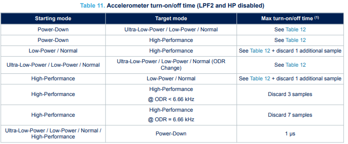

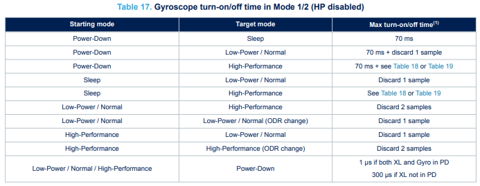

I'm not an expert in programming with NRF52xx DK platform, but please note that -at least- for the LSM6DSO dataout settings there are some timings to be waited for the integrity of the first data-out sample (see application note AN5192, p.21)
