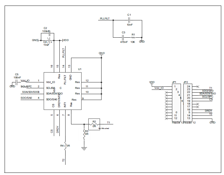

what exactly is your problem? Can you share your schematic?2018-06-28 8:25 PM
thank you for your reply.
I bought the steval-MKI125V1, and the schematic is here:

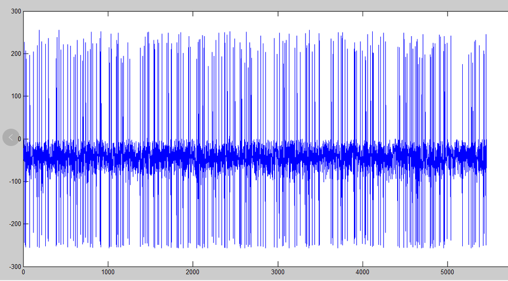

Now, I am able to read the angular rate of X,Y,Z, but there is a lot of noise. Here is Z axis data:
I really confused. Do I use the wrong way of getting those data? Or these noise is exist truly?
