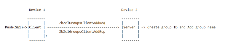

I made an example to understand the use of this cluster with a focus on ZbZclGroupsClientAddReq function:
The client send a Group Add Request to the server by pressing SW1
On receipt of this command, the server add the group ID and the group name ( if supported) to its group table, then generate the appropriate Add group response indicating success of failure.
The response is generated on client side AddGroupCallback
The response is displayed over the UART with the status, the source adresse, and the payload ( Group ID).
Please find in attachment files for both client/server.
