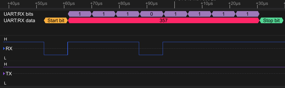

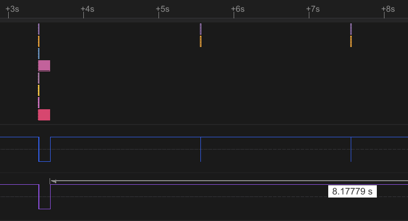

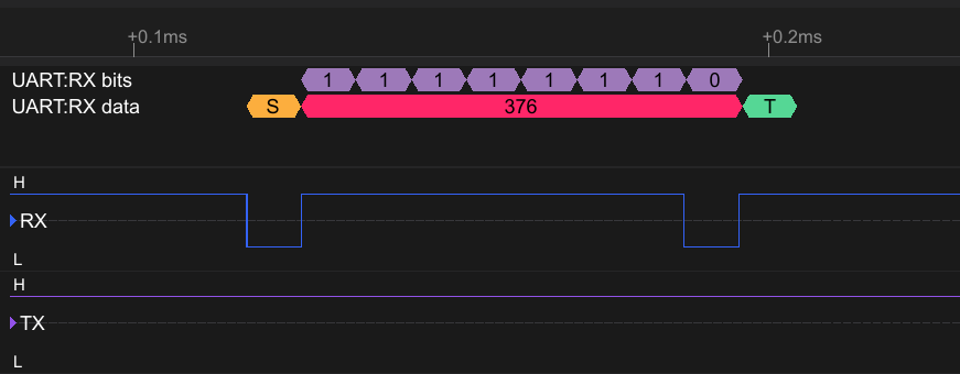

Observing the Signals on the UART-Pins (UART1_Tx and UART1_Rx) I get the following:
Big picture (Blue is STM32 UART_Tx)
1st transmitted byte 0x7F
2nd Transmited byte(after 2 seconds), I reversed the 0x7F incase the BLE reads in Bigendian.
In both cases, there is no response from the BLE Board.
