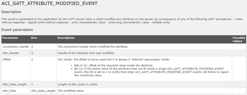

Hi Kayon,
This is interesting.
I think probably the stack has been updated and ACI_GATT_ATTRIBUTE_MODIFIED_EVENT format shall be the same as BlueNRG-1/2:
In this case, please try to modify evt_gatt_attr_modified_IDB05A1 structure like:
typedef __packed struct _evt_gatt_attr_modified_IDB05A1{
uint16_t conn_handle;
uint16_t attr_handle;
uint16_t offset; //4th 5th byte
uint8_t data_length; //6th byte
uint8_t att_data[VARIABLE_SIZE];
} PACKED evt_gatt_attr_modified_IDB05A1;When you saw event->data_length always being 0x10, i guess it was because bit 15 in real offset was 1 to indicate other events will follow for the remaining value.
And you saw event->offset having data length, because low byte in real offset (5th byte) is 0, which accidentally makes your offset having high byte equal to 0 and low byte equal to real data_length (6th byte).
These shall explain the length and offset fields.
Although it is still tricky because high byte of offset is supposed to be at 5th byte not 4th byte, which instead shall make your offset 0x0410 meaning 4 , and 0x1410 meaning 20.
But i cannot explain the dummy 2 bytes (00 00) in front of the data. I think it is probably safe to just ignore the 2 bytes.
Thus in the end, the structure will need to be:
uint16_t offset;
uint16_t dummy;
} PACKED evt_gatt_attr_modified_IDB05A1;Thank you.
