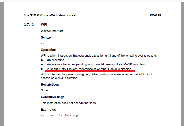

I rather expected that Debug Cell of ARM Cortex can be still controlled even if CPU is in WFI state.
[updated]: See description from Cortex-M0 documentation.Regards,
Piotr2018-05-12 7:01 AM
There are situations where it can't and that was the point.
Ok, but you're physically experiencing it NOT WORKING, these are complicated devices and interact with themselves in ways that a few bullet-points doesn't adequately capture.
You've either got to stop doing certain things so you can debug in the way you want, or you need to change the way you debug to accommodate the behaviour of the device.
Some times the act of observation alters the outcome of a test/experiment.
