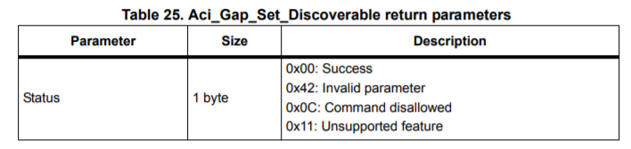

Hi, I also have the same problem, did you solve it?
I tried to debug and the value of ret here "ret != BLE_STATUS_SUCCESS" is 0x46 for me.
I have no idea why, it should be one of this values:
2021-10-22 3:19 AM
