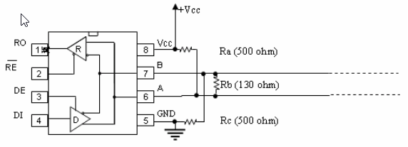

ST485 has an internal failsafe circuit useful when the differential input is floating, to avoid undefined state of the receiver that stays in a stable logic level.
However, the internal failsafe resistors are influenced from the external termination loader so that an external failsafe circuit is required if the termination resistor is present.
A typical failsafe configuration is shown below. The two resistors Ra (pull-up) and Rc (pull-down) should be 500Ohm while Rb (load) is 130Ohm.

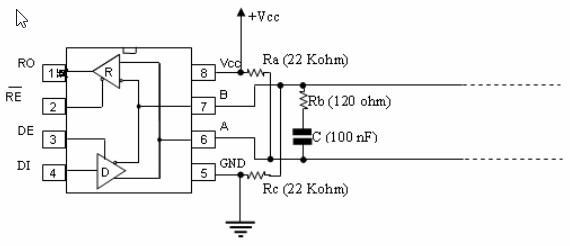

This load reduces the maximum numbers of transceiver connected to the network and causes a DC current consumption. Below is a solution of how to reduce the DC current.
