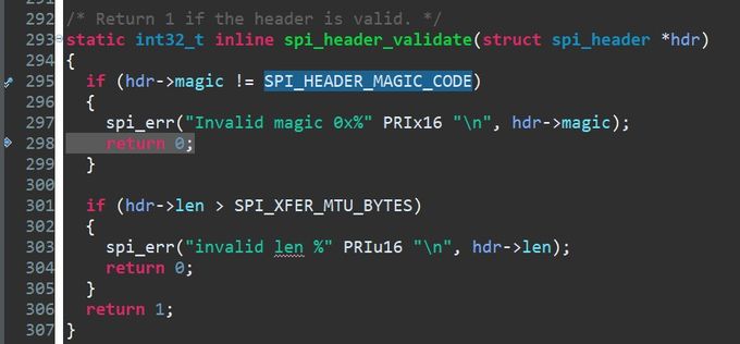

I just found that the magic seem incorrect: it will run into line 297...any ideas? :(

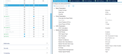

Dear Louis,

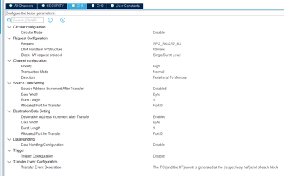

I had compared the SPI config in ioc, included DMA. it almost the same but just change to SPI2, not spi1.
I also found i had an error about DMA RX setting then correct it, but now, I got random magic number...
No idea what's wrong about SW.

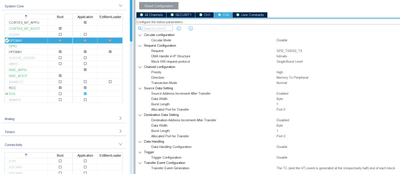

SPI2 setting:
DMA setting:
