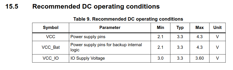

In fact, in the recommendations there is a different power range for the VCC_IO.

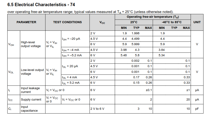

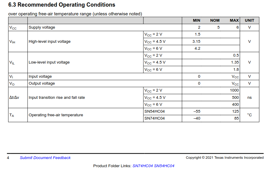

Manufacturers usually inform the values of VIH, VIL and VOH, VOL so that the user can confirm whether it will be possible to meet the parameters, but I did not find this, really weird. For example a datasheet of SN74HC04:

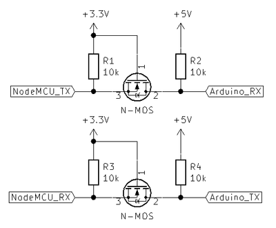

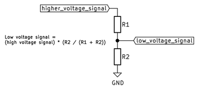

What type of data bus are you using? UART or I2C? It might be possible to implement the shift level using discrete components.
2023-07-31 3:15 PM - edited 2023-07-31 3:16 PM
Image sources: https://www.okdo.com/project/level-shifting/
AO3400 Gate Threshold Voltage: 1.45V and AO3401 Gate Threshold Voltage: 1.3V
