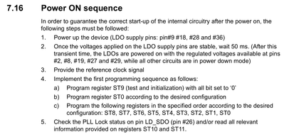

Are you following the power on sequence exactly?
2024-07-25 7:01 AM
Sort of because Im missing some information that does not allow me to completely verify that the power sequence is correct.
1. I measured this with an oscilloscope and all the inputs are receiving 5 V. Passed.
2. There is no way for me to certify this since I dont know what are the expected values to be read on these LDO.
3. Currently the board I have, does NOT have the reference clock signal and this is one of the questions I made. This is my first time interacting with a synthesizer and Im not really sure if you need to have some signal in place before actually communicate through SPI.
Based on this diagram, I can somehow infer that the spi block communication is separated from the rf stage. Please see spi-and-reference-signal-block.png
4. By the time this step is about to be made, 50 ms has elapsed since powering up the ic. I initially tried to do a write transfer on ST9 as in previous screenshots, but as this is a writing, I dont have any way to certify that the writing transfer is successful without actually getting back from the ic, so I tried to read the device id register ST11, without not having success. So, this step has not been made following exactly what it says because of my uncertainty of not know that ic is receiving the data.
Maybe I should try to follow exactly as its stated and see if when reading on ST11, I will get a response.
Maybe, all the steps below 5 needs to be made in order for the ic to reply back on ST11 as its stated on step 5.

During the last couple of days I implemented first the whole transfer that its given in section 7.17 of the data sheet with no success.
After that, I started to work on some parts of the circuit that were in charge of providing the reference clock signal as suggested by @AScha.3 and it has been proved that STW81200 indeed needs the reference clock signal to be able to reply through SPI.
The image attached is when the ic replies back when reading device id register.
