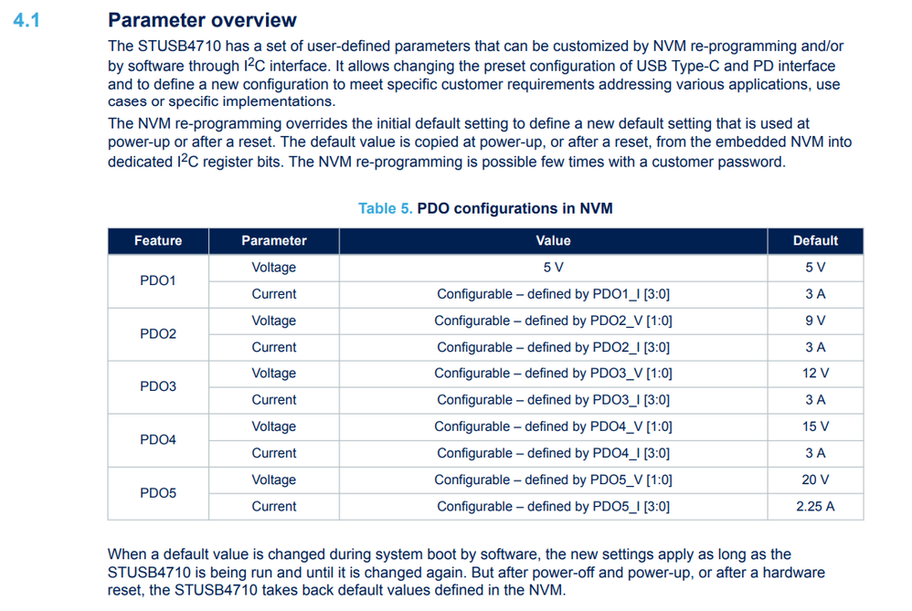

I apologize if the answer is obvious but I want to confirm my understanding for the STUSB4710 (USB-C PD controller). Section 4.1 of the datasheet mentions that the default values for the voltage and current settings, which require NO I2C programming. I can optionally choose to overwrite these values via an I2C interface if I want.
So if I use the 7.1. configuration, this means that, with no additional MCU, EEPROM or any other NVM, I can achieve:
5V, 3A (15W)
9V, 3A (27W)
12V, 3A (36W)
15V, 3A (40W)
20V, 2.25A (45W)
Is this logic correct?
2023-02-01 12:41 AM
Hi KMew,
your understanding is correct. This is the default configuration that is set in ST plant, ready to use for compatible 45W applications.

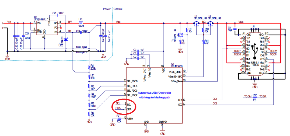

2023-02-01 7:18 AM
Hello Benoit,
Thank you for the confirmation!
I am using the buck design that is used in the datasheet to get that 45W application. This is strictly for power and we are doing NO data transmission. I am also doing no communication with an NVM or MCU, since I only want to use the default configuration. If that's the case, can I leave these two pins (SCL & SDA) floating? Is there anything else that has to change on this if I am just doing default power delivery?
2023-02-01 7:47 AM
Hi KMew,
so in this case, you can connect these pins to GND indeed.
