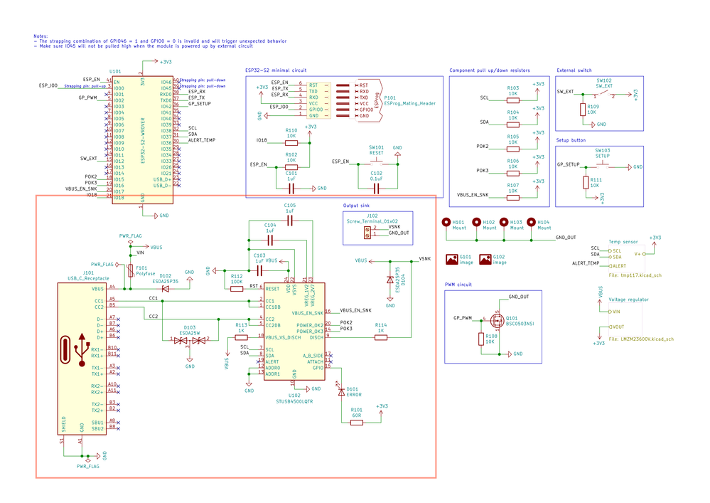

Hello, for my project I have decided for negotiating 20V using USB-C PD protocol, to power an external LED lighting.
My circuit design comes from the minimum implementation in the datasheet, but I've decided to get rid of the p-MOSFET as I don't need on/off switch on the sink. I believe that the negotiation is happening on the CC lines, so hopefully, this decision shouldn't interfere. According to the datasheet, the VBUS_EN_SNK pin is an open-drain which I believe could even be left unconnected.
I am unable to negotiate any voltage above 5V. I've tried to use both factory settings of the chip and also programming the NVM contents by myself.
Here is the schematic of the circuit:
I've already inspected the board for soldering problems and tried four different pieces. The EVAL-SCS002V1 board is working as expected using the same USB-C power adapter, as well as the SparkFun Power Delivery Board.
This is the content of the NVRAM I tried (apart from the factory defaults):
00 00 b0 aa 00 45 00 00
10 40 9c 1c ff 01 3c df
02 40 0f 00 32 00 fc f1
00 19 57 ff f7 bf ff 00
00 4b 90 21 43 00 48 fbIs there any other purpose for the original PMOS, other than switching on and off the external device? Or any ideas on what could be wrong?
Thanks

2020-10-16 12:44 PM
Be careful that there are 2 versions of the chip:
From your schematic, we can see it contains the STUSB4500LQTR.
And the EVAL-SCS002V1 eval board that you mentionned, is also for STUSB4500L.
So the L version only support 5V. That's why you cannot negociate 20V.
If you want to negotiate on CC line a Voltage higher than 5V (on VBUS), please use the STUSB4500 (non-L version)
Regards
2020-10-16 3:09 PM
Hi, thanks a lot for the answer. You're right, I got the wrong chip, but I was reading the correct STUSB4500 datasheet all the time. Unfortunately they're almost indistinguishable from each other, even all the I2C commands goes through.
2020-10-16 7:15 PM
To avoid using the wrong device, it is not useful to read first (through I2C) the DEVICE_ID register (located at address @0x2F) because it is similar.
For STUSB4500: DEVICE_ID == 0x21 or 0x25
For STUSB4500L: DEVICE_ID == 0x25
It is better to read the marking on the package.
