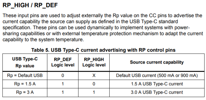

Yes, as it defines the source current capability. The actual current depends on the device being attached.
