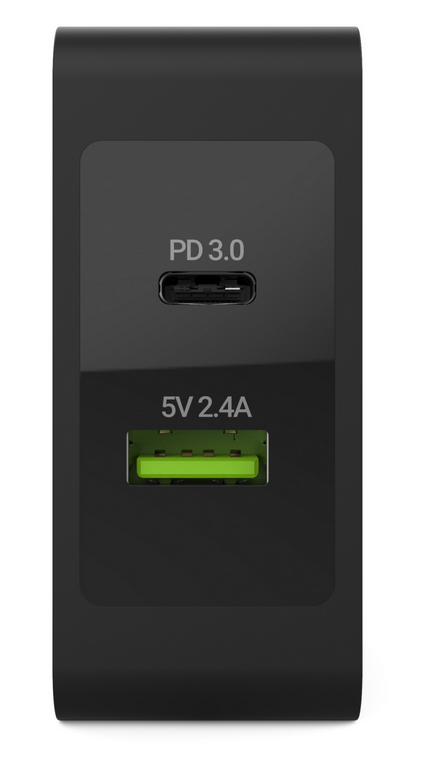

As for the mentioned charger, it consists of 2 ports: USB A and USB C:

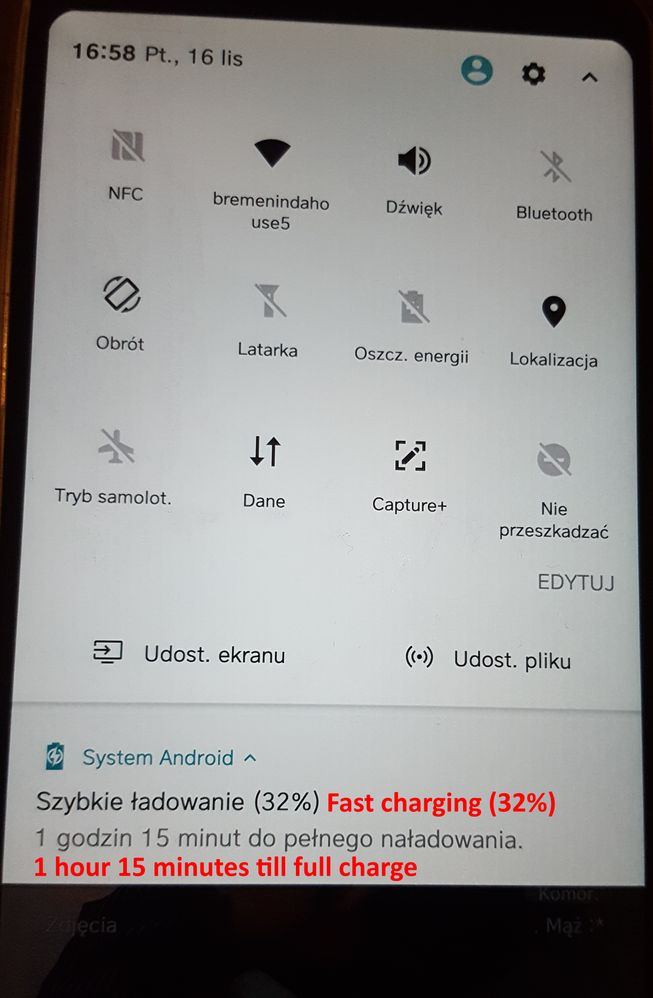

If I connect my android phone to the USB C (USB C ,-> USB C cable), I get a system message that fast charging is in progress:

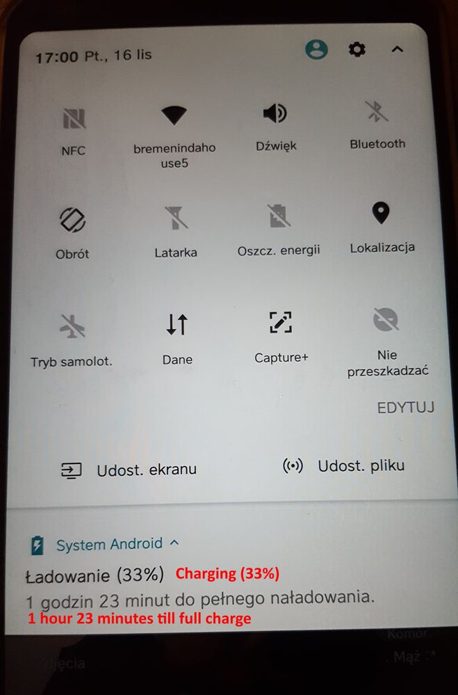

While if I connect it to the USB A ports (using USB C to USB A plug cable), I get regular charging:
This would suggest that the phone made a handshake with the charger over USB C. I wonder why didnt this work with the eval boards.

Also please note that your charger also support former Qualcomm QC3.0 on top of USB PD, which is likely the fast charge protocol also implemented in your smartphone. This protocol is not implemented on the eval board you have.
