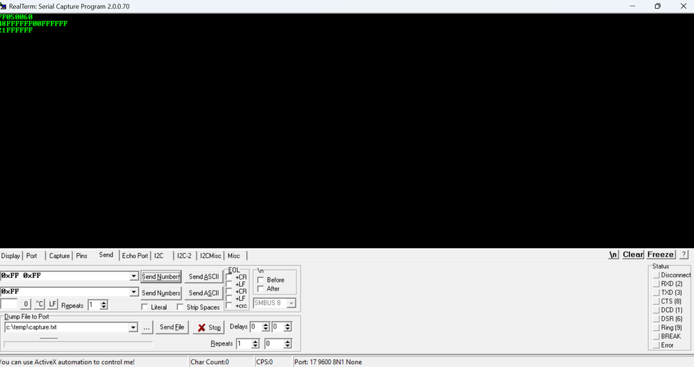

I have developed code in arduino IDE , I am only getting the output receive from UART 04000A075 . I understand that this is the default value in register DSP_CR1. Could someone please tell me what does this mean.
I hereby provide the code for receiving and transmission of signal from STPM34 to ESP32 using UART.

What testing/investigation have you done to determine whether the problem is with the STPM34 or the ESP32 - or both?
Show your connections.
See this for some tips on debugging serial comms.
2025-01-06 10:14 PM
I have tried using Real term to send command frames in the format 0xFF,0x00,0x60,0x00 to write data in to registers of STPM34. Also checked if it gave back any response if I send 0x0A,0xFF as in the datasheet of STPM34 it is mentioned that when we are sending a data to read a register of STPM34. If it receives an address value first it gets ready that register to send a data after receiving next value. When I checked STPM34 using Real term I connected Rx and Tx of STPM34 to a TTL. But I was unable to receive any response.
When I used ESP32 to write and read data from STPM34 I used the method used in the code given above and also tried to read the data byte by byte, but this was also unsuccessful.
2025-01-07 1:41 AM
If you always receive the content of the first register (0x04 00 00 A0), it probably means that the STPM3x does not understand your command.
Please refer to the starting guide attached, it gives important tips for UART/SPI communication, including:
- the init sequence at power up: the SCS signal must be at high level when power supply and EN signal rise (to select UART mode) and then, you must correctly reset the chipset, using SYN and SCS signals
- the UART access mode: at first command, the chipset always sends back the first register content. With the second command, it sends back the answer to the first command. With the third command, it sends back the answer to the second command, and so on.
- you will find example of the CRC calculation for UART and SPI, you can check that your CRC calculation is correct
Finally, if you can share a snapshot of the UART communication (TX and RX bit), it would be helpful.
Best regards,
Didier
2025-01-07 3:59 AM
2025-01-07 4:01 AM
Here I connect STPM34 Rx and Tx to a TTL and communicate using Real term, and I send data in this format to get a response. Correct me If it is wrong approach to debug the issue.
2025-01-07 5:34 AM - edited 2025-01-07 7:39 AM
I have also attached an example of a first typical UART access.
You can see that the answer on RX is 0xA0 00 00 04 75 (CRC).
I hope it helps.
