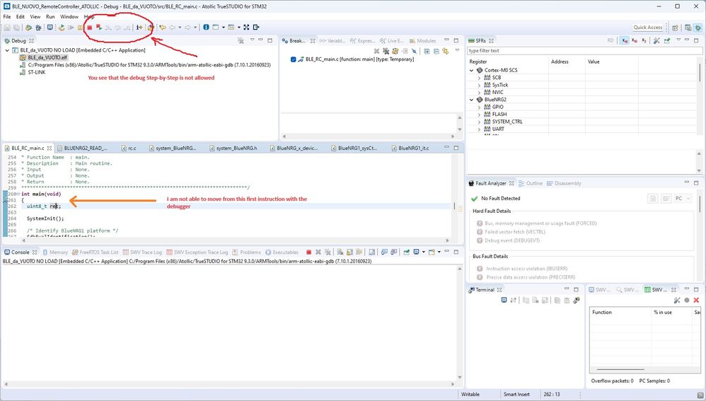

You see below a picture of the debug window: the standard step by step debug is not allowed.

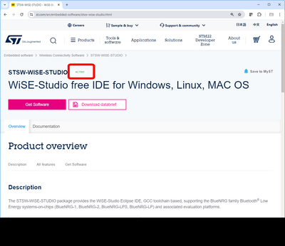

ST say it's 'ACTIVE':
https://www.st.com/en/embedded-software/stsw-wise-studio.html

@MSand.1 wrote:
I was told that Wise Studio is also an old IDE.
