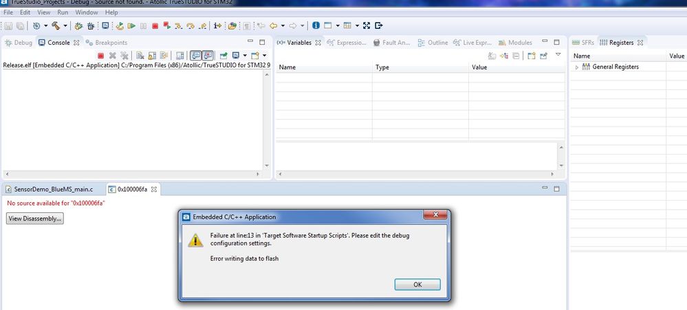

Please help I'm stuck with this, I am currently having some difficulties while programming and debugging the BlueNRG-2 ''STEVAL-IDB008V2'' over STLink/v2.
PROBLEM FACED : When trying to debug and flash the code using TrueStudio getting following error message
Failure at line:13 in 'Target Software Startup Scripts'. Please edit the debug configuration settings. Error writing data to flashDetails:
Board : STEVAL-IDB008V2
BlueNRG2 Part Number :[/b] BLE232ESIDE Version : Version: 9.0.1, Build id: 20180420-1214Project : Imported from BlueNRG-2 Navigator ExamplesExample : BLE_SensorDemo_BlueMSappBuild Status : SuccessHardware Test : OK - Tested by flashing code using : 1. BlueNRG-2 Navigator over USB-Serial, and 2. BlueNRG-1 ST-Link Utility over STLINK/V2.Additional Information:
Console Message while debugging
Atollic TrueSTUDIO gdbserver for ST-Link. Version 4.2.2 (WIN32 2018-02-26 16:20:21 15675)
Copyright (c) 2018, STMicroelectronics. All rights reserved.Starting server with the following options: Persistant Mode : Disabled LogFile Name : debug_log.txtLogging Level : 31Listen Port Number : 61234Status Refresh Delay : 15sVerbose Mode : Enabled SWD Debug : EnabledAtollic TrueSTUDIO gdbserver for ST-Link. Version 4.2.2 (WIN32 2018-02-26 16:20:21 15675)
Hardware watchpoint supported by the target STM32 device: Flash size =256Enter STM32_AppReset() function NVIC_DFSR_REG = 0x00000009XPSR = 0xC1000000ST_LINK Major version =2 Jtag version =31ST_LINK VID=1155 PID=14152ST_LINK device status: HALT_MODEST_LINK detects target voltage =3.24 VoltST-Link device initialization OKWaiting for debugger connection...Waiting for connection on port 61234...Accepted connection on port 61234...Debugger connectedST_LINK device status: HALT_MODEReading 0x4 bytes of memory from addr 0x100006fa Reading 0x2 bytes of memory from addr 0x100006fa Enter STM32_AppReset() function NVIC_DFSR_REG = 0x00000009XPSR = 0xC1000000Flash erase: Address= 0x10040000, Length=92160 Flash write: Address= 0x10040000, Length=192 Programming flash.. STM32 device: flash programming successful 0x10040000 Flash write completed in 0.198000 seconds, 0.946970kB/sFlash write: Address= 0x100400c0, Length=2944 Programming flash.. STM32 device: flash programming successful 0x100400c0 Flash write completed in 0.301000 seconds, 9.551495kB/sFlash write: Address= 0x10040c40, Length=2960 Programming flash.. STM32 device: flash programming successful 0x10040c40 Flash write completed in 0.305000 seconds, 9.477459kB/sFlash write: Address= 0x100417d0, Length=2944 Programming flash.. STM32 device: flash programming successful 0x100417d0 Flash write completed in 0.304000 seconds, 9.457237kB/sFlash write: Address= 0x10042350, Length=2944 Programming flash.. STM32 device: flash programming successful 0x10042350 Flash write completed in 0.307000 seconds, 9.364821kB/sFlash write: Address= 0x10042ed0, Length=2944 Programming flash.. STM32 device: flash programming successful 0x10042ed0 Flash write completed in 0.311000 seconds, 9.244373kB/sFlash write: Address= 0x10043a50, Length=1896 Programming flash.. STM32 device: flash programming successful 0x10043a50 Flash write completed in 0.275000 seconds, 6.732954kB/sFlash write: Address= 0x100441b8, Length=108 Programming flash.. STM32 device: flash programming successful 0x100441b8 Flash write completed in 0.202000 seconds, 0.522123kB/sFlash write: Address= 0x10044224, Length=48 Programming flash.. STM32 device: flash programming successful 0x10044224 Flash write completed in 0.264000 seconds, 0.177557kB/sFlash write: Address= 0x10044254, Length=124 Programming flash.. STM32 device: flash programming successful 0x10044254 Flash write completed in 0.204000 seconds, 0.593597kB/sFlash write: Address= 0x100442d0, Length=66 Programming flash.. STM32 device: flash programming successful 0x100442d0 Flash write completed in 0.214000 seconds, 0.301183kB/sFlash write: Address= 0x10044312, Length=16 Flash write completed in 0.057000 seconds, 0.274123kB/sReading 0x20 bytes of memory from addr 0xf0000fd0 Reading 0x4 bytes of memory from addr 0xffffffff Reading 0x4 bytes of memory from addr 0xffffffff Enter STM32_AppReset() function NVIC_DFSR_REG = 0x0000000BXPSR = 0xC1000000Startup Scripts -> Target Software Startup Scripts

Hi Dilbert,
Did you debug with the default DK "BLE_SensorDemo_BlueMSapp" project?
Probably it was because the device entering standby state, which disabled SWD pins (IO9 and IO10).
To recover this situation, the following options are recommended:
1) Disable deep sleep by changing call to BlueNRG_Sleep() as follow:
2) Use a GPIO to wakeup the system and grant access to the debugger. User may need to change the call to BlueNRG_Sleep() as follow:
Please refer to BlueNRG-1,2 Debugging Tips for more details:
C:\Program%20Files%20(x86)\STMicroelectronics\BlueNRG-1_2%20DK%203.1.0\Docs\BlueNRG-1_Debugging_Guidelines\BlueNRG-1_Debugging_Guidelines.html
