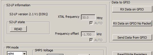

STEVAL-FKI868V1 does somebidy nows how the boards finds the offset? marco

Implementing this compensation in our projects would be very usefull !!
the two demo boards i have do this compensation . this way i can lower the channel space .i changed the xtal with a tcxo
i don't immagine how a board compensetes it self if they anyway run with a quartz !!

Not sure why two boards couldn't attempt to align themselves more tightly.
Going to depend a lot of the granularity of the PLL/VCO in getting to the ~868 MHz (or whatever exact value it is trying to mix in the down-converter), and the ability to pull that to correct for the offset of the local oscillator.
Winfred LU
The S2-LP has been calibrated at factory.
And frequency offset is stored in the on-board EEPROM.
The GUI gets the offset value from the EEPROM.
