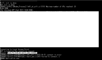

I am currently working on a feasibility project using the X-NUCLEO-67W61M1 and NUCLEO-U575ZI-Q.
The sample code I am using is ST67W6X_FOTA.
The FOTA functionality is working properly. However, during the initial connection phase, there is about a 50% chance of encountering Wi-Fi connection-related errors. The errors I have observed include:
"Wi-Fi connect timeouted"
"Wi-Fi connect in error"
"Failed to initialize the DTIM"
Whenever these issues occur, the only way to recover is by resetting the MCU and restarting the process.
Are there any recommended methods or best practices to resolve these issues?

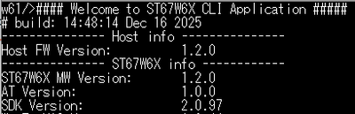

2026-04-13 2:22 AM
Hi @Louis AUDOLY
I am using MW version 1.2.0 and SDK version 2.0.97, both downloaded from GitHub.
https://github.com/STMicroelectronics/x-cube-st67w61
Additionally, where can I download the version you mentioned?
The GitHub repository still only shows the v1.2.0 tag.

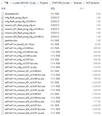

2026-04-13 6:13 PM
Hi @Louis AUDOLY ,
I downloaded the archive using the "Download latest" option from the webpage you provided. However, the version number inside the archive does not match the 2.0.106 version you mentioned. Could you please help confirm whether this version has actually been released?

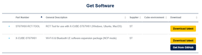

2026-04-14 6:28 PM
Hi @Louis AUDOLY ,
I downloaded the file using the "Get Latest" option on the official website, but it doesn’t seem to be the correct one.
In any case, I was able to successfully download the correct file from GitHub. Thank you for your help.
