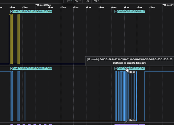

each transaction with the NCP starts with: "magic" keyword 0xAA55, length of data to be transmitted (2 bytes) and 4 empty (reserved) bytes. If the length is non-zero, there should be a follow-up transaction with the specified length.
So, during the initialization, you will get 0xAA 0x55 0x09 0x00 (5x) - this means that the NCP is ready to transmit 9 bytes. The host needs to provide the clock for 9 additional bytes and receive the data from NCP, as in the screenshot below.
