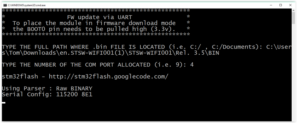

UART Method
1. Place J4 so BOOT 0 is high. 2. HW reset the module 3. Run the FW_update.bat 4. I make the on screen selection as follows, but it hangs here
