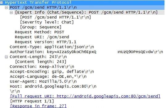

Hey J,
I played a little bit with wireshark. I sniffed the packets send by my PC program, that works with gcm. I've seen there, that between the Content-xxxx messages are \r\n. So I tried this also with the SPWF. But when I have there \r\n between e.g. ''Content-Type'' and ''Content-Length'', I didn't sniffer any HTTP packets any more, just tcp packets. Without the \r\n, I also sniffer HTTP packets send by the SPWF. Do you have an idea why didn't sniff any HTTP packets when I have the \r\n in my header? Thx & regards, Flow2016-03-29 2:03 AM

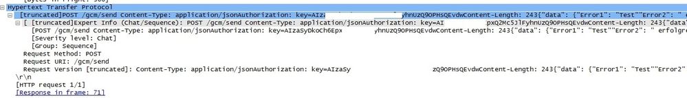

Hi Flow,
no idea for this. Bytes you see in the wireshark, are the ones you fill in the module by HTTPREQ command. Module does not append nothing by itself. Second picture shows a ''Truncated'' request. The string ''POST something HTTP/1.1'' is really ''POST something other...''. Seems like string provided to HTTPREQ is not well formatted. Try to sniff the UART link between module and external MCU. Try also to put a delay between HTTPREQ command's <CR> and following payload (request string), just to be sure that characters are not lost over serial line. Let me know. jWe’re moving the ST Community to a new platform to give you a better and more reliable community experience.
