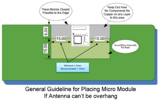

If antenna cannot be mounted in an overhanging position, then the followed guidelines must be made to keep area clear of copper:
as recommended in Figure 3:

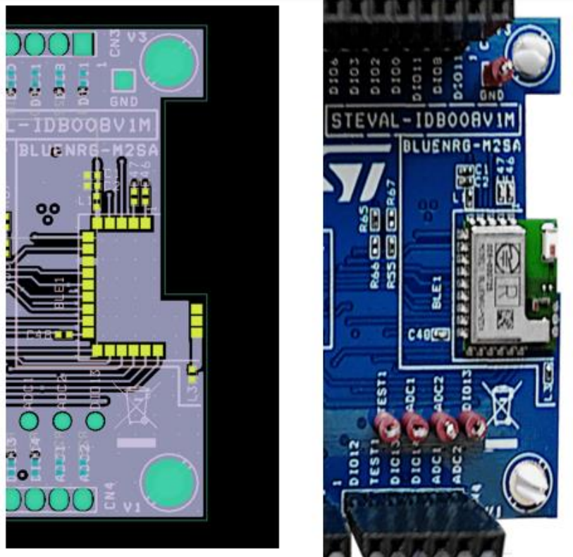

It's STEVAL-IDB008V1M
Under BLUENRG-M2SA is copper with VIAs.
Is it normal?
Note:
• All unused pins should be left floating; do not ground
• All GND pins must be well grounded
• The area around the module should be free of any ground planes, power planes, trace routings, or metal for 6 mm from the module antenna position, in all directions.
• Traces should not be routed underneath the module
2022-05-20 10:07 AM
Yes. It is normal.
This is about the area around the module antenna. There should be not copper 6mm from the antenna position.
Vias are not traces. The vias just stitch the ground planes together.

I'm not sure if the discrepancy between the recommended keep out area in Figure 3 and the evaluation board (STEVAL-IDB008V1M) layout in Figure 4 of the DT00142 BLE module integration design guidelines was properly answered.
The 6th bullet under the basic guidelines says, "Add an uninterrupted ground plane on host board, directly underneath the top shielded zone of the module." The note in Figure 3 then indicates that there should be no components or copper on any layer 6mm from the top edge of the BlueNRG-M2 module. The BlueNRG-M2SA evaluation board floods all layers under the entire module with ground. This is in direct contradiction with the note in figure 3.

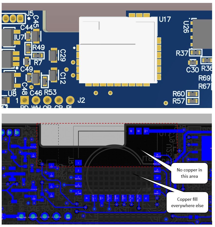

On my layout (see photo below), I removed copper from any layer 6mm from the edge of the the BlueNRG-M2SA module. This has the ground plane starting at about pins 2 and 18 on the module.
Should the layout match the guidelines or the evaluation board layout?
