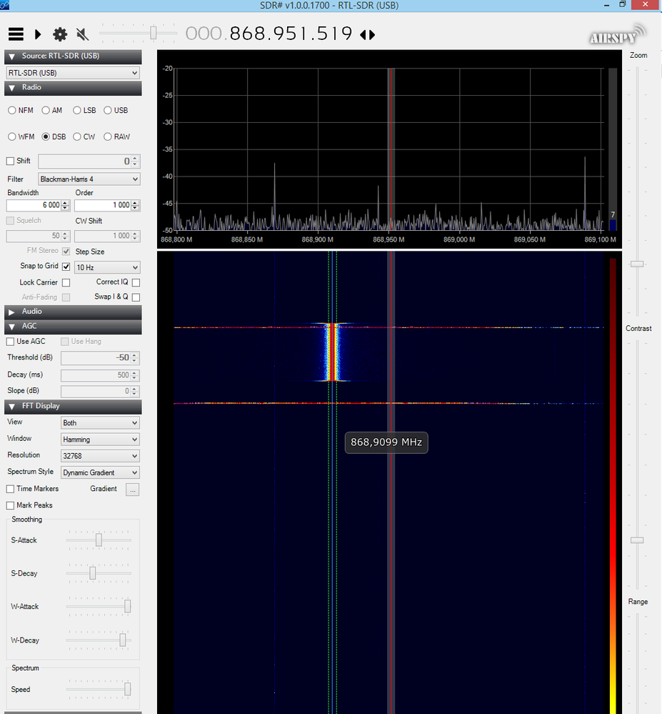

Checked with r802t and sdrsharp, looks like frequency offset is smaller than 10khz, with 50khz frequency deviation it's not easily noticeable. My rtl-sdr has 40khz offset, 868.95 looks like 868.91 in sdrsharp, but single tone is exactly in center of other wmbus devices present nearby.
Single tone:

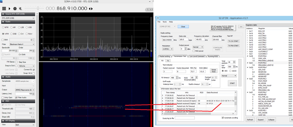

Captured packets from meter and my device:
Upper line in waterfall is packet sent from my device, lower line in packet sent from meter, order is reversed in s2lp dk log window.
actual packet sent from my device was "17 C0 A8 97 59 08 43 FF FF FF FF FF FF 01 00 18 00 00 00 00 00 00 44 43" (bytes written to tx fifo), PCKTLEN1:PCKTLEN0 was set to 0x18. But it came in as "01 1F 31".

Good. It shows that it is not an issue due to uncalibrated frequency.
