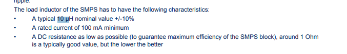

no 2.2µH coil can NOT be used for S2LP transceiver SMPS block. It is not the same design than WB MCUs.
You MUST follow the characteristics described in S2LP datasheet:
regards
