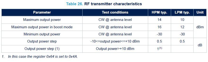

From the datasheet:
The application uses a 0.5dB output power step for the complete range. Is this wrong?
Below the table is a note to the PA_CONFIG0 (0x64) register. Which values should be used for PA_DEGEN_TRIM for different output powers?
