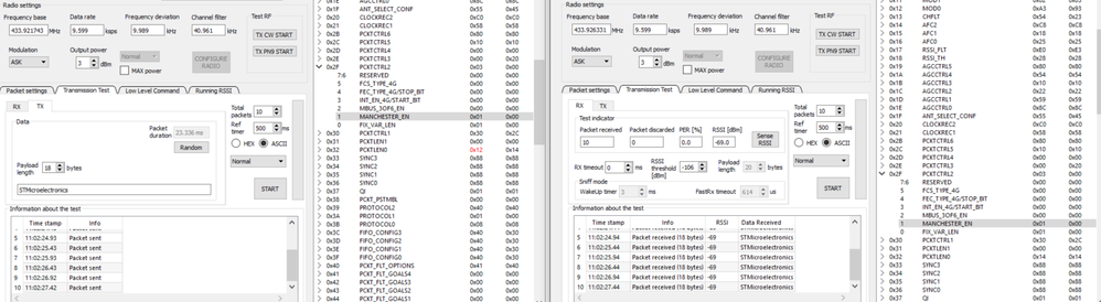

I have tried setting the MANCHESTER_EN register and a huge combination of data rates etc in order to get some sensible data in the S2-LP GUI, but nothing is consistent or representative of the data I expect to see.
I can see the data correctly using a different receiver, also with rtl_433 and SDR software.
Should ASK Manchester data be receivable using the S2-LP IC?
I have tried pretty much every combination of settings and parameters I can think of and I don't appear to be making any progress.
Thanks.

Hello, i tried with 2 stm32l053 + x-nucleo-s2868a1, what is your µC board ?
i guess s2lp can receive ask manchester
