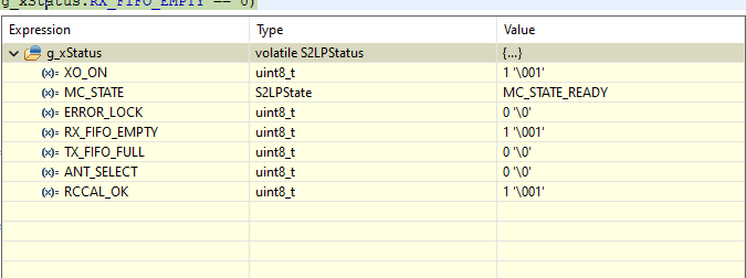

My customer installed some sites with cards with S2-LP (one central board and one remote).
On a particular location the S2-LP crashes. Now I'm searching the problem but while I'm searching I would like that the customer resets the S2-LP (not the entire card) remotely by IOT and avoid to visit the site.
But calling a second time MX_X_CUBE_SUBG2_Init() doesn't work. After this the SPI works correctly (I'm polling the chip ID) but there is no more interrupt generated by the S2-LP(checked with the scope on the 4 GPIO).
Any idea?
Status seems correct:
