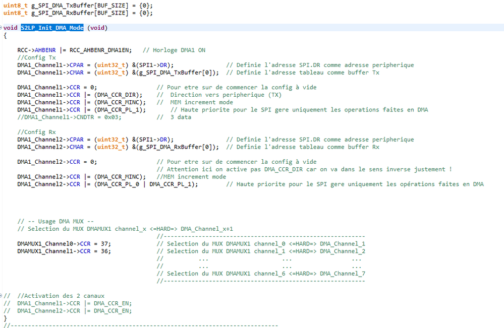

I have a function that initializes the DMA portion :

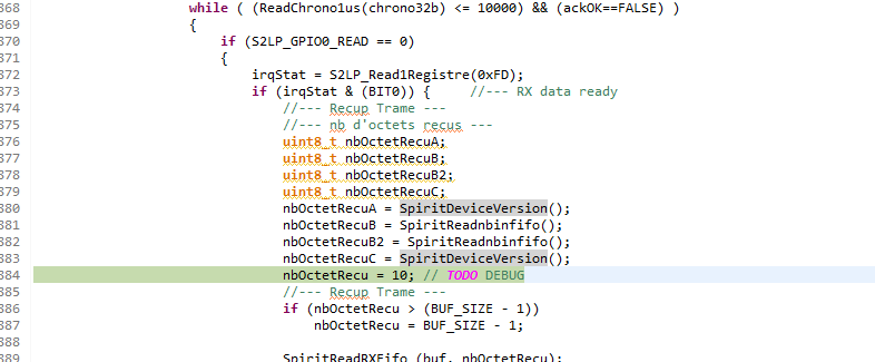

In my code I try to read information in DMA through the SpiritDeviceVersion and SpiritReadnbinfifo functions:
However, I get my data, but only when I call a DMA read 2 times :
nbOctetRecuB = the value I should read from nbOctetRecuA (0xC1)
nbOctetRecuB2 = the value I should read from nbOctetRecuB (0x0A, my FIFO element count)
nbOctetRecuC = the value I should read from nbOctetRecuB2 (0x0A, my FIFO element count) => whereas I expect 0xC1.

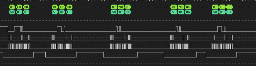

All is correct on SPI Wires as you can see below (Last ligne is CS#, Frequency 1MHz, and I have try 4MHz):

2025-10-20 4:49 AM
Thanks for the LA screenshot.
Does it show the DMA or non-DMA case?
Do you see any differences?
2025-10-20 4:55 AM - edited 2025-10-21 1:47 AM
That's the problem, I havent any differences on SPI bus..

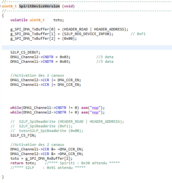

The Screenshot show the DMA-case , so when i'm using DMA actually, i need to do that to get my data and not the previous (SPI 1 time and DMA read 2 times):
uint8_t SpiritDeviceVersion (void)
volatile uint8_t toto;
g_SPI_DMA_TxBuffer[0] = (HEADER_READ | HEADER_ADDRESS);
g_SPI_DMA_TxBuffer[1] = (S2LP_REG_DEVICE_INFO0); // 0xF1
g_SPI_DMA_TxBuffer[2] = (0x00);
S2LP_CS_DEBUT;
DMA1_Channel2->CNDTR = 0x03; //3 data
DMA1_Channel1->CNDTR = 0x03; //3 data
//Activation des 2 canaux
DMA1_Channel2->CCR |= DMA_CCR_EN;
DMA1_Channel1->CCR |= DMA_CCR_EN;
while(DMA1_Channel1->CNDTR != 0) asm("nop");
while(DMA1_Channel2->CNDTR != 0) asm("nop");
// S2LP_SpiReadWrite (HEADER_READ | HEADER_ADDRESS);
// S2LP_SpiReadWrite (0xF1);
// toto=S2LP_SpiReadWrite (0x00);
S2LP_CS_FIN;
DMA1_Channel1->CCR &= ~DMA_CCR_EN;
DMA1_Channel2->CCR &= ~DMA_CCR_EN;
//==========================2eme lecture==========================
// while(DMA1_Channel1->CNDTR != 0) asm("nop");
// while(DMA1_Channel2->CNDTR != 0) asm("nop");
while (!(DMA1->ISR & DMA_ISR_TCIF2))
// NOP ou rien
asm("nop");
DMA1->IFCR = DMA_IFCR_CTCIF2; // clear flag
//==========================Fin 2eme lecture=======================
toto = g_SPI_DMA_RxBuffer[2];
return toto; //**** Spirit1 : 0x30 attendu *****
//**** S2LP : 0x91 attendu *****
}I have try another flag to check DMA here but no difference.
