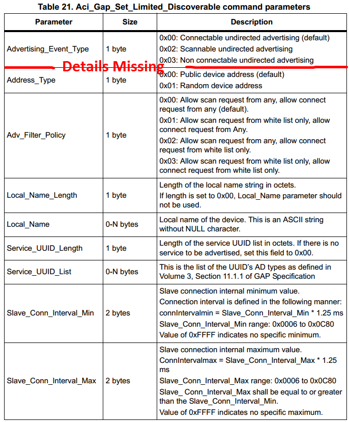

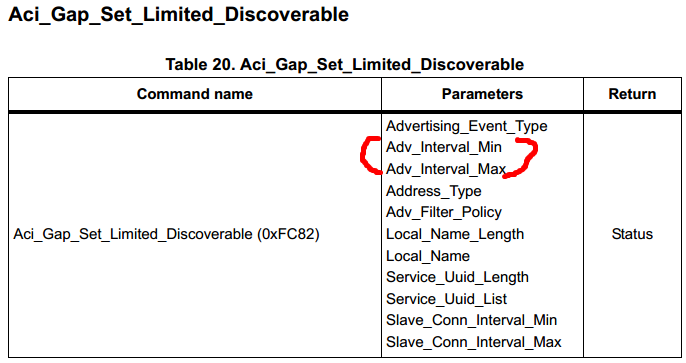

I need to adjust the Advertising Intervals (min/max) associated with the ''
Bluehci_Gap_Set_Limited_Discoverable
'' command which is described on pages 30-31 of the UM1755 BlueNRG Bluetooth LE stack ACI User Manual (linked on the BlueNRG product page).This command has the parameters:
where I need to understand the details of Adv_Interval_Min and Adv_Interval_Max.
However no details are provided. The User Manual says this about these parameters:
and in the detailed listing of the command parameters, these two parameters are entirely missing!
Can you please provide details for these two parameters: Adv_Interval_Min and Adv_Interval_Max
If this information is available somewhere, please point me to it.
Thank you very much!
#adv_interval_min #advertising-interval #adv_interval_max #bluehci_gap_set_limited_discoverableSolved! Go to Solution.
2017-07-14 1:50 AM
Dear Lance,
they are 2-byte little endian parameters. As for the endianess, please notice that it's already handled by the library included in the SW package.
Parameter
Size
Description
Advertising_Interval_Min
2
Minimum advertising interval. Range: 0x0020 to 0x4000 Time = N * 0.625 msec Time Range: 20 ms to 10.24 sec
Advertising_Interval_Max
2
Maximum advertising interval. Range: 0x0020 to 0x4000 Time = N * 0.625 msec Time Range: 20 ms to 10.24 sec

2017-07-14 3:52 AM
If you specify 1 as the parameter, the corresponding interval will be 1 * 0.625 ms, i.e. 0.625 ms.
Hope that helps,
Antonio
