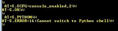

As I said, I followed the istructions in the application note. Therefore, I set 'console_enabled' to '2' but the answer is like this:

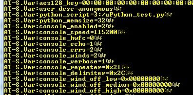

And I checked the value of 'console_enabled':

I found a solution. After change 'console_enabled' to 2, I need to save the configuration variable to no volatile storage (AT&W).
Restart the module and now shell started.Thanks for the support.We’re moving the ST Community to a new platform to give you a better and more reliable community experience.
