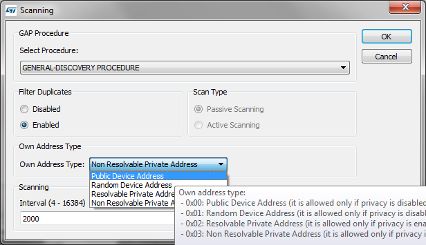

2018-02-06 9:02 PM
Hi KC,
In Scanning dialog, there should be an option ''Own Address Type'' to choose Public Device Address:
Best Regards,
Winfred
