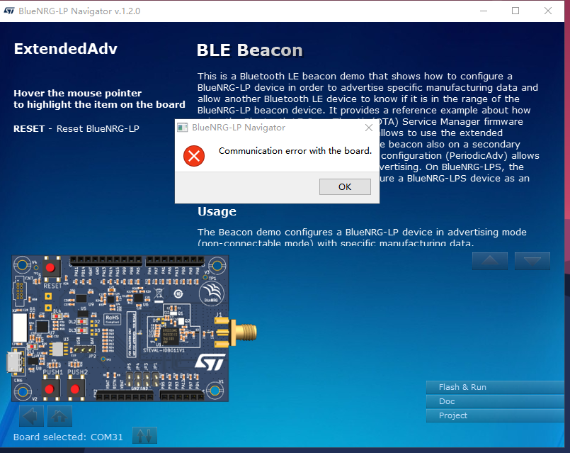

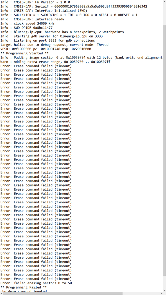

When i use WISE Studio Build the demo project, Then Run;There comes the problem.My computer can recognize the board.

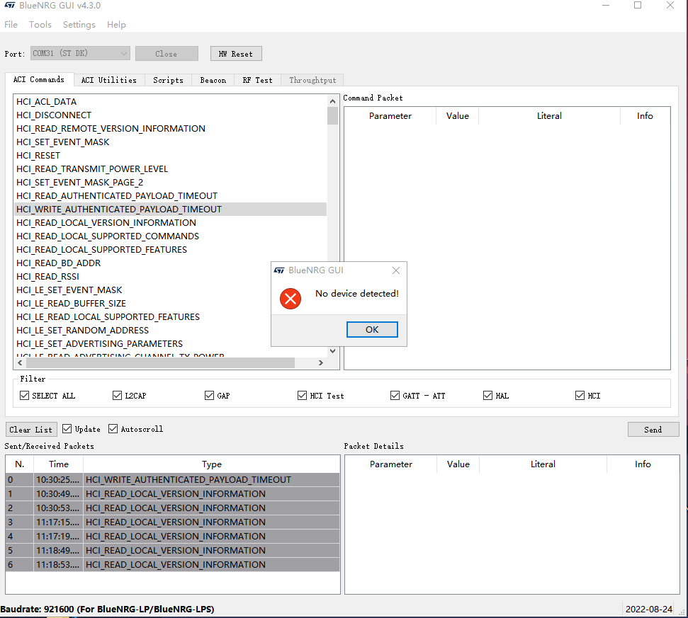

Also The BlueNRG GUI Tools can read DK Serial port .But can not Successfully connected.
There also the BlueNRG-LP Navigator tools.I don't know why this problem occurs.anybody have any idea?

2022-08-29 7:36 PM
thanks for your suggestion. i have tried Reflash USB_CMSISDAP_LPS.hex, it's ok. Then, when i flash the binary. there also something wrong as I described before. Howerer, When I jump wire to another same Blue-NRG-LP chip, also use DAP for downloaders. WISE Studio can normal flash the binary. So, maybe something wrong with my BLE chip.
